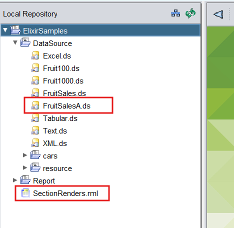

  • Template: repository:/ElixirSamples/SectionRenders.rml
  • Datasource: repository:/ElixirSamples/DataSource/FruitSalesA.ds

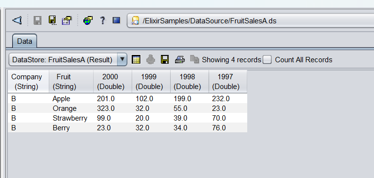

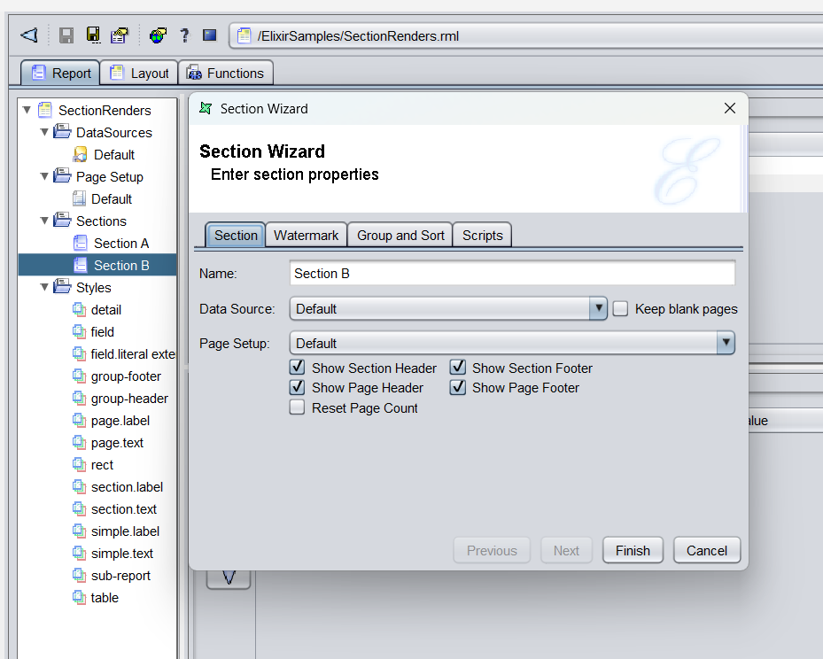

The sample looks up the value in the Company field and renders either Section A or Section B.
Steps

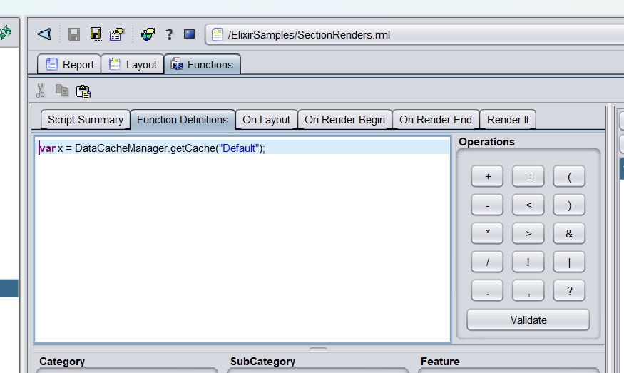

  1. Open SectionRender.rml and add the following in the Functions Definition tab:
    var x = DataCacheManager.getCache("Default");
    Explanation
    • The DataCacheManager saves the datasource values in the cache
    • Change “Default” to the name of your datasource.

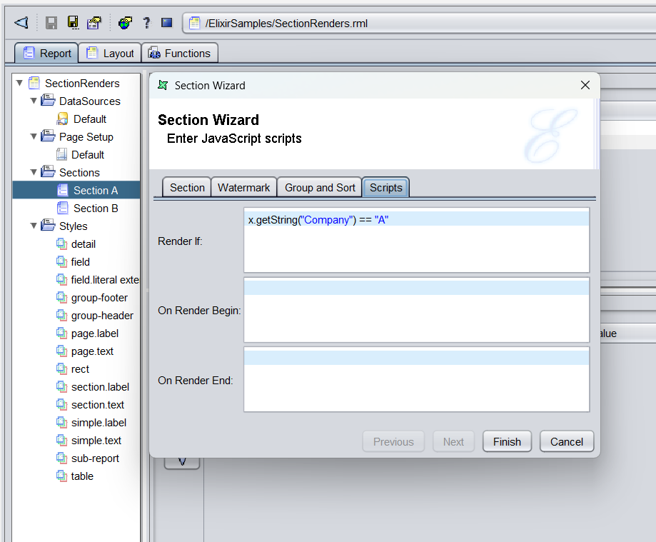

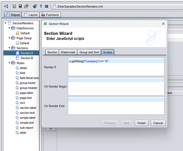

  2. Add the following to render-if in each Section’s script tab:
    • Section A
    x.getString("Company") == "A"

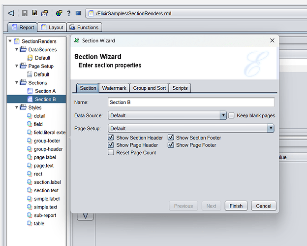

    • Section B
    x.getString("Company") == "B"

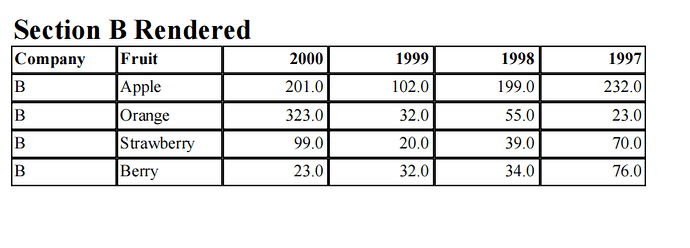

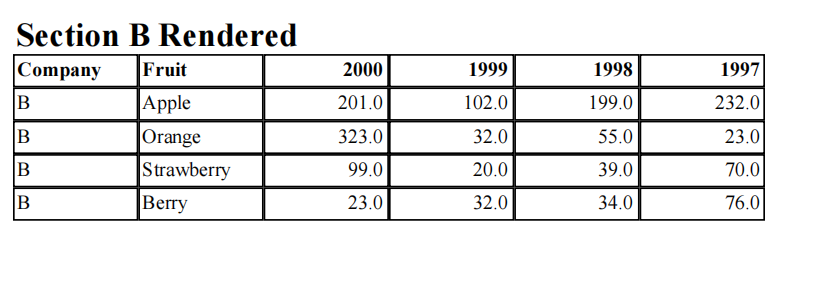

  3. When rendering the template, the section displayed is determined by the value of the Company field. In this example, since the datasource specifies Company B, Section B will be rendered.
