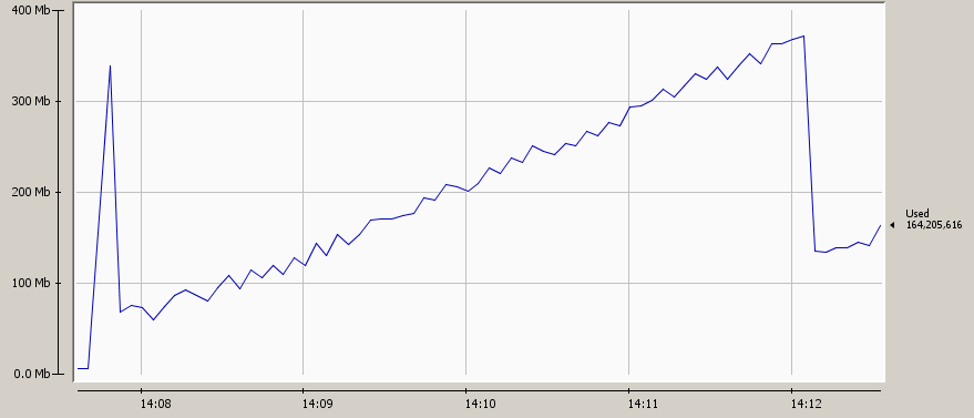

2/ Next, Report Generation of 100,000 records & un-checking “Keep Page Count” -
From the above, you can see that the memory utilised for this report generation takes approximately only up to 400MB.
Therefore, the concluded result shows the performance improvement by un-checking “Keep Page Count” Property.
