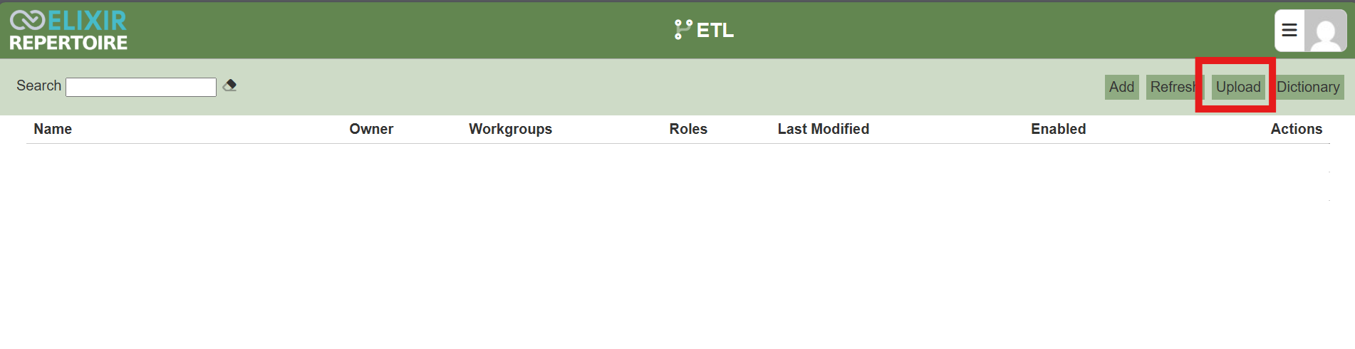

  • Upload the ETL chainset into your Repertoire ETL module.

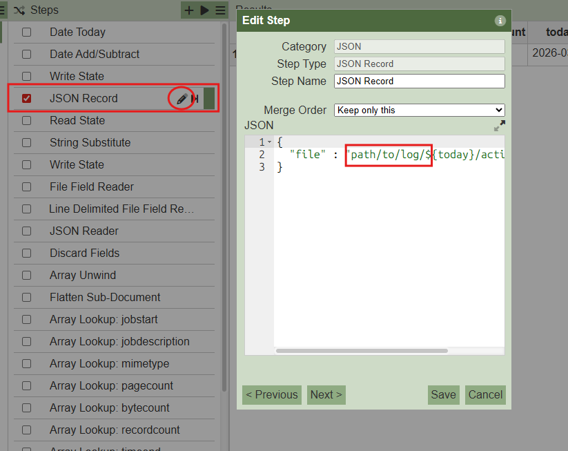

  • Change the path to your log file by clicking on the fourth step, “JSON Record” and click Save.

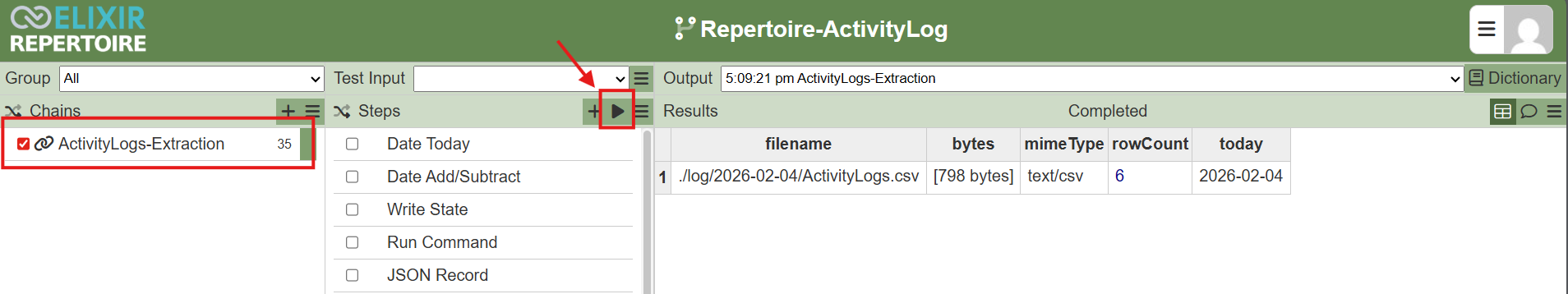

  • To test and verify the ETL chainset works, click on the chainset name, and click on the play icon.
  • The ETL process will output a file ActivityLogs.csv. This CSV will contain the activity logs for the previous day, located in the /logs folder.

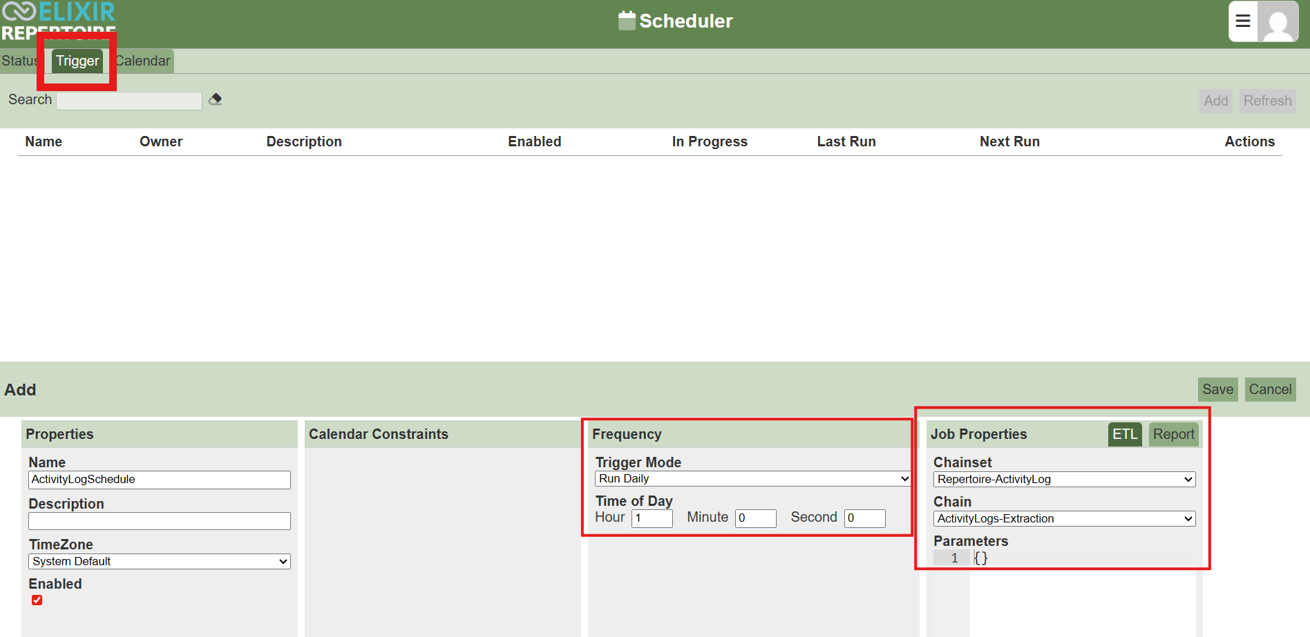

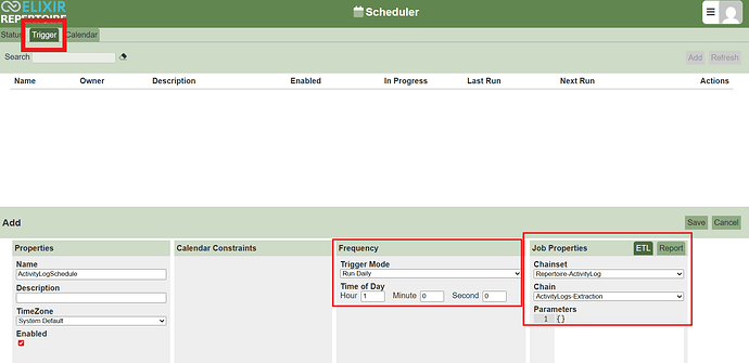

  • Using the scheduler module, schedule the ETL chainset to run daily at 1:00 AM.
  • This ensures that each morning you have a fresh ActivityLogs.csv containing the activity logs from the day before.
